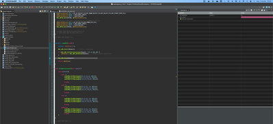

2025-02-12 8:44 AM
Always 0
I don't know if I'm configuring something wrong2025-02-12 8:45 AM
