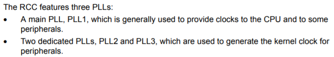

2018-04-26 6:52 AM
Hi
Skelton.Merle
,Your request will be deeply reviewed by our STM32CubeMX experts.
However, I have some comments:
-Amel
2018-04-26 9:48 AM
I have MCO2 mapped to PC9. When I connect MCO2 to PLL2P output, AND MCO2 is the ONLY user of PLL2P, HAL_RCCEx_PeriphCLKConfig() will not enable PLL2P as MCO2 is not in the
PeriphClkInitStruct.PeriphClockSelection list and no peripheral is using PLL2P.
I am suggesting that when an MCOx pin is connected to a PLLx output, the MCOx must be in the
PeriphClkInitStruct.PeriphClockSelection list and HAL_RCCEx_PeriphCLKConfig() must check for the MCOx as if it is a peripheral so it can enable the PLLx output.
I have also noticed that once CubeMX enabled a PLL, it will not disable it when there are no peripherals connected to it. So with CubeMX, once a PLL is enabled, it is forever enabled in CubeMX, although if no peripherals are connected, the CubeMX code does not enable the PLL outputs.
