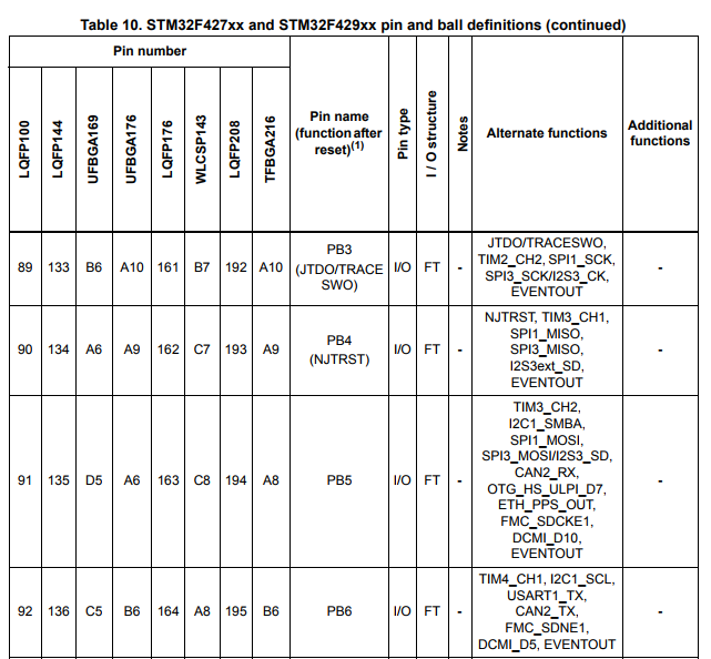

Hello, I am using CAN2 at stm32f429zı. But PİNS of CAN2 ı dont use. when ı use PB5/PB6 CAN2 is working why?

,You would check the the pins assignment in theSTM32F429datasheet relevant to your device
The specific alternate function assignments for each pin are detailed in the datasheet, Table 10 STM32F427xx and STM32F429xx pin and ball definitions:
PB5 and PB12 are used for the
CAN2_RX
signal.
PB6 and PB13 are used for the CAN2_TXsignal.
