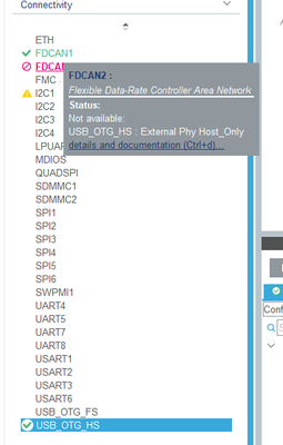

Doing the exercise on STM32CubeMX, it seems you cannot use FDCAN2 with USB_HS with external PHY as they share some IOs:
So you can't use both USB_HS and FDCAN2 at the same time. Unfortunately, no alternative for FDCAN2

2025-05-21 8:02 AM
2025-05-21 8:05 AM
yes this was the confirmation required, No alternatives ?
2025-05-21 8:07 AM
Already answered that question in my previous comment: "Unfortunately, no alternative for FDCAN2"
