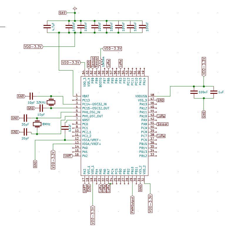

I'm mounting my MCU on PCB. I have done the schematic referring from https://www.st.com/resource/en/datasheet/stm32l476je.pdf . Please help me verify this. My conditions are as follows.
NOTE: Please let me know does VDD USB pin can support 5V DC? If not, then how a program should be uploaded to the MCU?

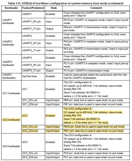

Thanks, TDK. I have followed AN2606 (Page329/417, Table. 133) and understood the I2C connection procedure. I have modified the circuit, it would be very helpful if you kindly verify and let me know whether that is correct or not. As per your advice, I'll go for PCB fabrication. Your prompt response will be helfulful.
