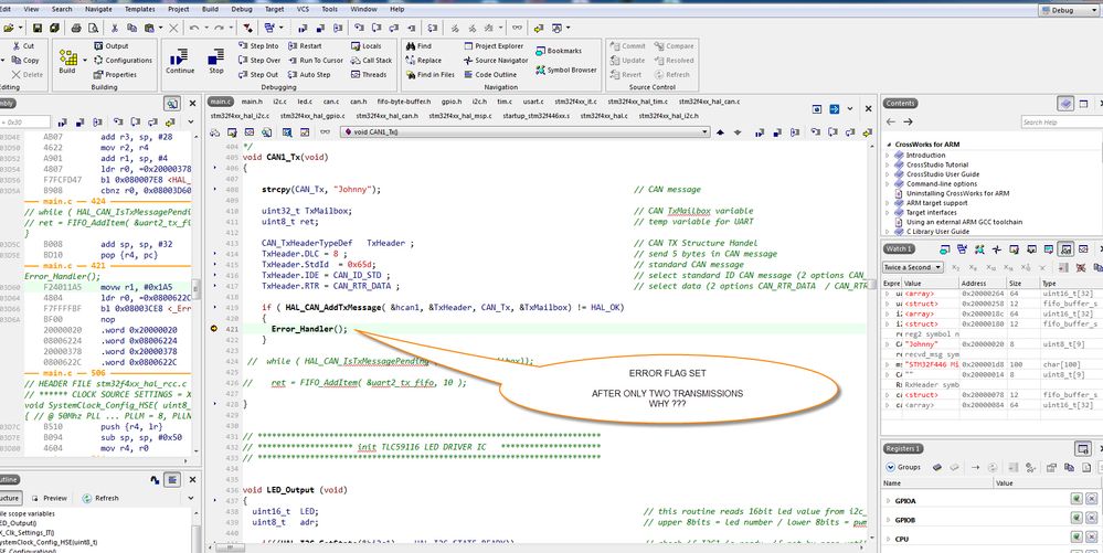

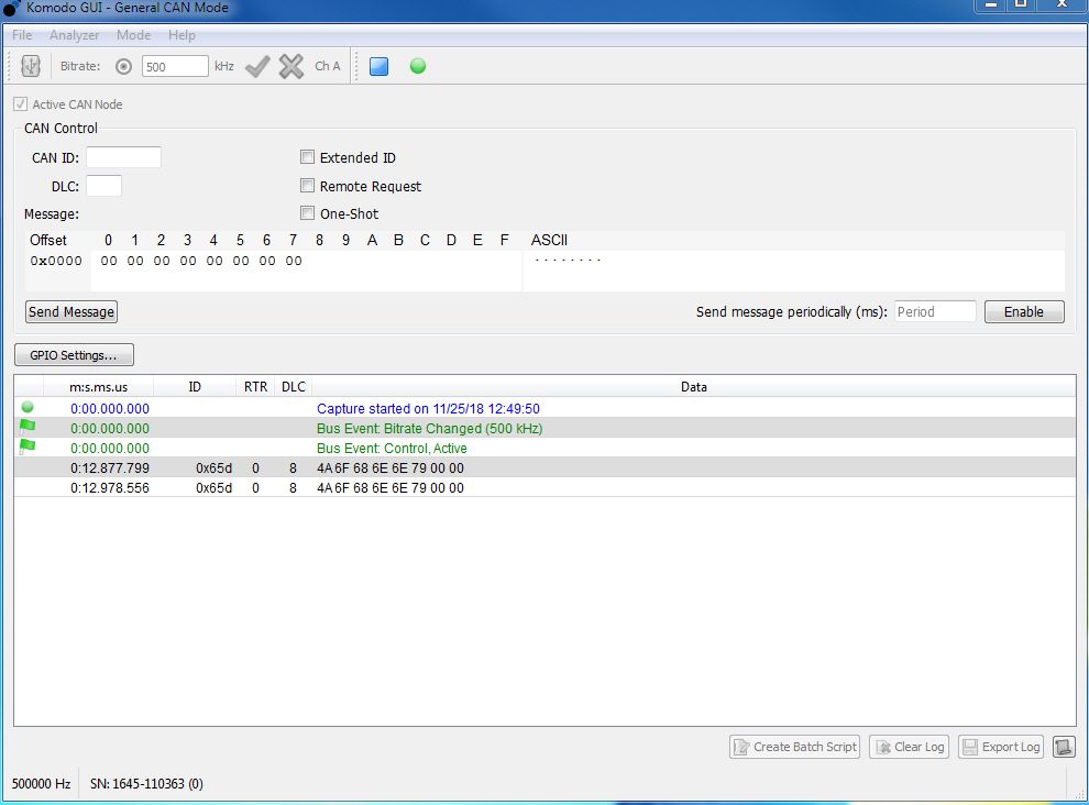

here you can see successful messages sent on the can bus but only 2/3 before the error in the HAL_CAN_AddTxMessage() code ??
here we can see two / three messages getting sent before the error at the HAL_CAN_AddTxMessage code

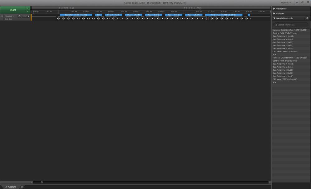

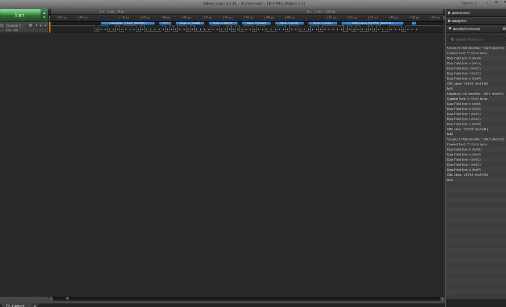

This is on the CAN RX pin of the Nucleo Board
This is on the CAN TX Pin Of The Nucleo Board
Both in my logic anylyser and CAN Bus Analyser I can see the successful transmission of the two messages
WHY WHY WHY is the ARM triggering an error ???? after only sending 2 messages
It should send the messages for the next year! or until I hit the stop button in my debugger

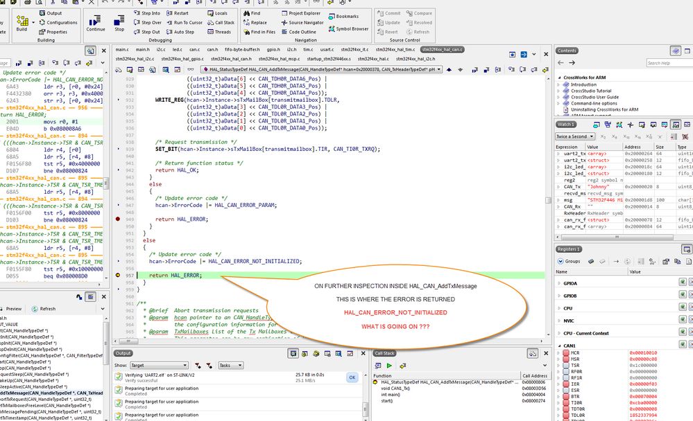

ON FURTHER TESTING .?????? ... WHAT IS GOING ON, the returned error is HAL_CAN_ERROR_NOT_INITIALIZED
it's already sent two/three messages and now it is saying it's not initialized
are these HAL APIs buggy or flawed ??
this error is both in loopback and normal mode, is it because it is in interrupt mode ?
