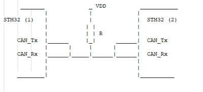

2026-01-15 6:24 AM - edited 2026-01-15 6:30 AM
That could work with this config (I remember I tested it years ago):
CAN_Tx in open drain/common GND:
or CAN_Tx in Push-pull with common GND of all circuits:
but not recommended for high distances.

2026-01-15 8:07 AM - edited 2026-01-15 8:10 AM
That shouldn't work as the UART does: with cross connection of Tx <-> Rx. There is an arbitration and acknowledgement mechanism in CAN communication that should be kept in place that Tx <-> Rx cross connection doesn't permit.
2026-01-15 8:17 AM - edited 2026-01-15 8:18 AM
In the configurations proposed above, the arbitration and acknowledgement are seen on any Rx from all Tx of the available CAN nodes (frame broadcast) which is the case where transceivers are used.
2026-01-16 1:03 AM - edited 2026-01-16 3:01 AM
To answer that question:
@inky wrote:
I don't follow why the RX and TX of both chips are joined together, instead of the UART configuration. Please explain
In the CAN protocol, every node on the bus should listen continuously to what happening on the bus.
Even if there are only two nodes on the CAN bus, these mechanisms couldn't be established when a cross connection of CAN_Tx <-> CAN_Rx is adopted.
That's why RX and TX of each node are joined together in the above configuration to let the sender listen to what it is sending.
Hope it's clear now.
