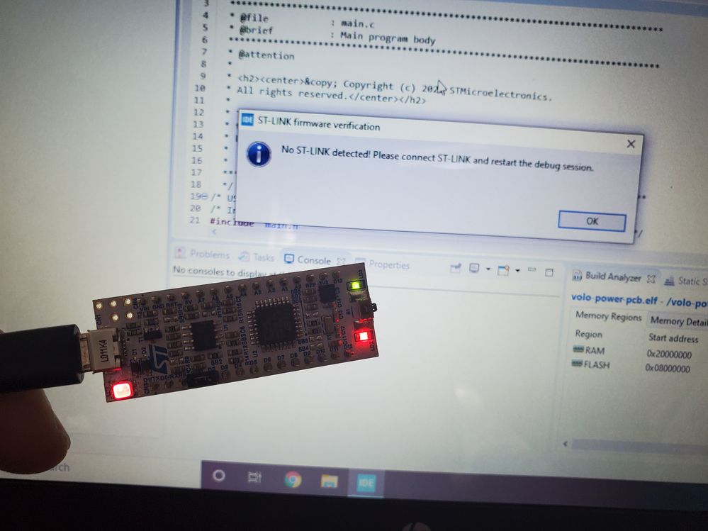

I have a NUCLEO-L011K4 dev board, and unfortunately I can't get any of the sample programs to work. The board doesn't show up on the host machine. I'll walk you through the steps I tried on Windows, but I also on Mac and it didn't work there either:
How can I work around this? I think the root issue is the OS isn't seeing the board. I tried two different brand new NUCLEO-L011K4 boards so I don't think it's an issue with the board hardware.

2020-07-26 8:04 AM
The board LEDs behave as expected, the board seems to be powered up correctly. If you remove the jumper the green LED flash frquency will change (default firmware).
The board should show-up in three ways on a PC, e.g. in the device manager;
The "USB-Stick"/Disk (==USB mass storage class) driver is an OS driver which should function without installing any additional software or driver.
Using a different USB cable maybe a good idea. Plus re-installing the drivers.

Thanks y'all! Swapping out the USB cable did the trick. The device not showing up as a USB device on multiple machines should have clued me in. Up and running now :rocket:
