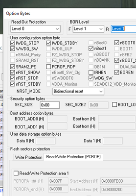

I am using an STLink-V3Minie. I can look at the Option Bytes:
The Read/Write Protection is not checked so it is not on. Further, I have tried the JLinkSTM32 executable to reset options back to factory settings, said that worked.
