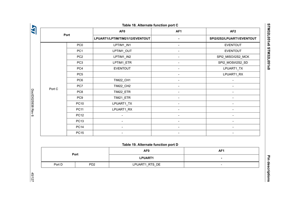

Reading the datasheet, on the Port C are reported several alternate functions. But the descrption of AF it is only for port A and B.
Is it possible to have the AF descrption for the Port C too? Could take quite a long time to guss the correct mux.

From an older version of DS:
PS.
@Imen DAHMEN can you please have a look at this? It appears to be a serious regression. Thanks.

It seems tha part that lacks in the recent versions..

The table you have shared is correct.
I asked for the document correction update in internal ticket 125576.
