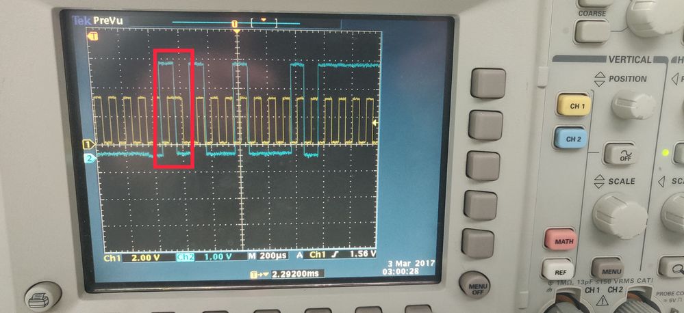

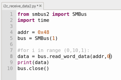

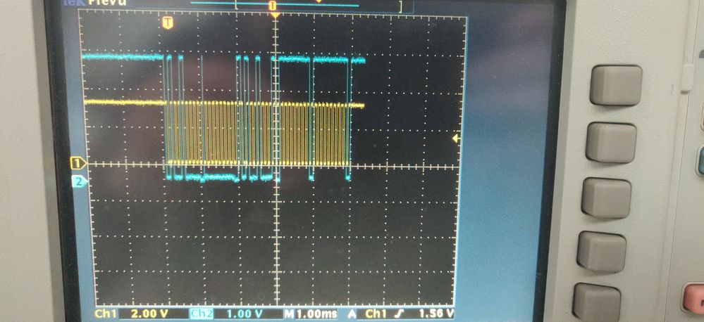

In the code below I send 2 bytes with my STM32 (I've chosen a number higher then 255 (340) so it needs to send the data in 2 bytes) but on the scope I cant find this data. I guess it's because of the wide clockpulse and the Rpi expect an ACK. Instead of the data, I receive 2 times 0xFF data.
I dont know if it matter but I enabled Clock Stretching
Can someone please help me, im way to long stuck on this part of my project
Below my STM32 code, my python script and photo's of the oscilloscope.

Seem to have opened multiple threads on basically the same topic (RPi I2C)
Really not a RPi focused forum here.
I2C has very lax rules on clocking, what actually matters is SDA vs the SCL edge
Your code doesn't look to be acting as an STM32 side I2C slave.
Perhaps look at some Master/Slave examples
STM32Cube_FW_L4_V1.15.1\Projects\STM32L476G-EVAL\Examples\I2C\I2C_TwoBoards_ComPolling\readme.txt
