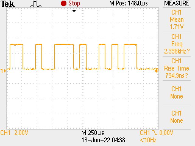

I can "tap into" the ESP32 TX pin and connect this to a USB serial port RX pin and see the data while it boots, but the STM32 simply does not see it. I've look at the data on the scope, and logic levels are correct.

I solved this. The issue is that performing a UART write (serprintf) inside the interrupt was detrimental to performance and the interrupt wasn't actually getting the data.
