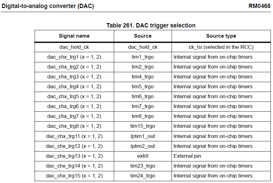

According to RM0468 Reference manual, STM32H723/733, STM32H725/735 and STM32H730 Value line. DAC conversion may be triggered by TIM1/2, TIM4~8, TIM15 and so on. DAC conversion may also be triggered by external pin: exti9.

I suppose, the idea is, to use Timer (such as TIM12) to trigger DMA transfer automatically in a desired period, the DMA will perform transfer from memory (data buffer) to DAC data holding register (such as DAC_DHR12R1), and DAC output is updated in very short time with TEN1=0 (data written into the DAC_DHR1 register are transferred one dac_pclk clock cycle later to the DAC_DOR1 register).
I think this should work.
