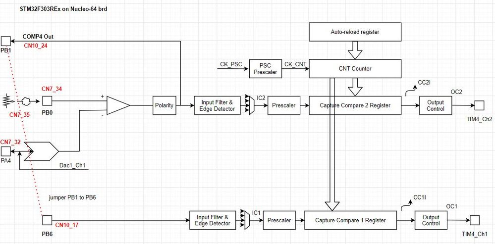

That's the strange thing; no code change. The COMP4 output is always present on PB1. With no input on PB6 (TIM4_Ch1) both TIM4_CH1 and TIM4_Ch2 do not run. Then I connect a jumper wire (real-time) from PB1 to PB6. When I do this both TIM4 CCR1 and CCR2 start capturing.
I'll go through the pin out of the Nucleo-64 F303RE again and also matrix connection for PB1 & PB6 going to TIM4_Ch1 and TIM4_Ch2.
I'm attaching an updated block diagram adding TIM4_Ch1 and showing the jumper wire. Also, FYI, when I do this both dma channels start running.

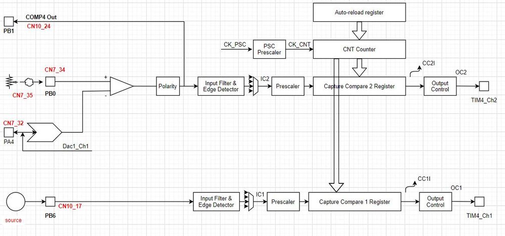

I changed my setup to run an external clock source into PB6 (CN10_17). When I do this BOTH TIM4_Ch1 and TIM4_Ch2 start capturing in CCR1 and CCR2 the same value. It's almost like IC1 and IC2 are both receiving TIM4_Ch1 input.
Block diagram attached.
2020-07-25 10:48 AM
And don't they? What's the CCMR1 setting?
Is this still the Nucleo board? Maybe you could strip down the code to an absolute minimal but compilable example, preferrably not depending on Cube or any other "library", and post.
