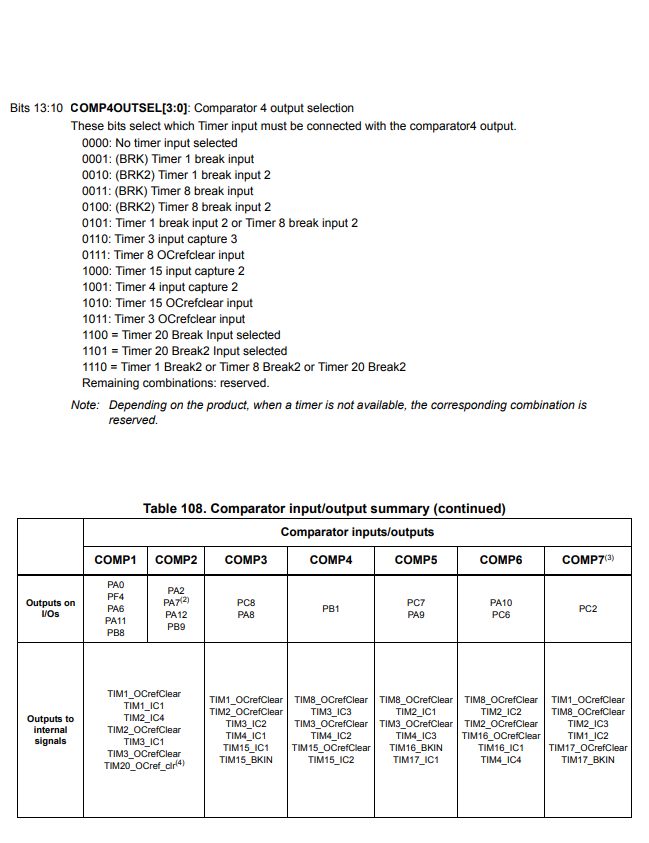

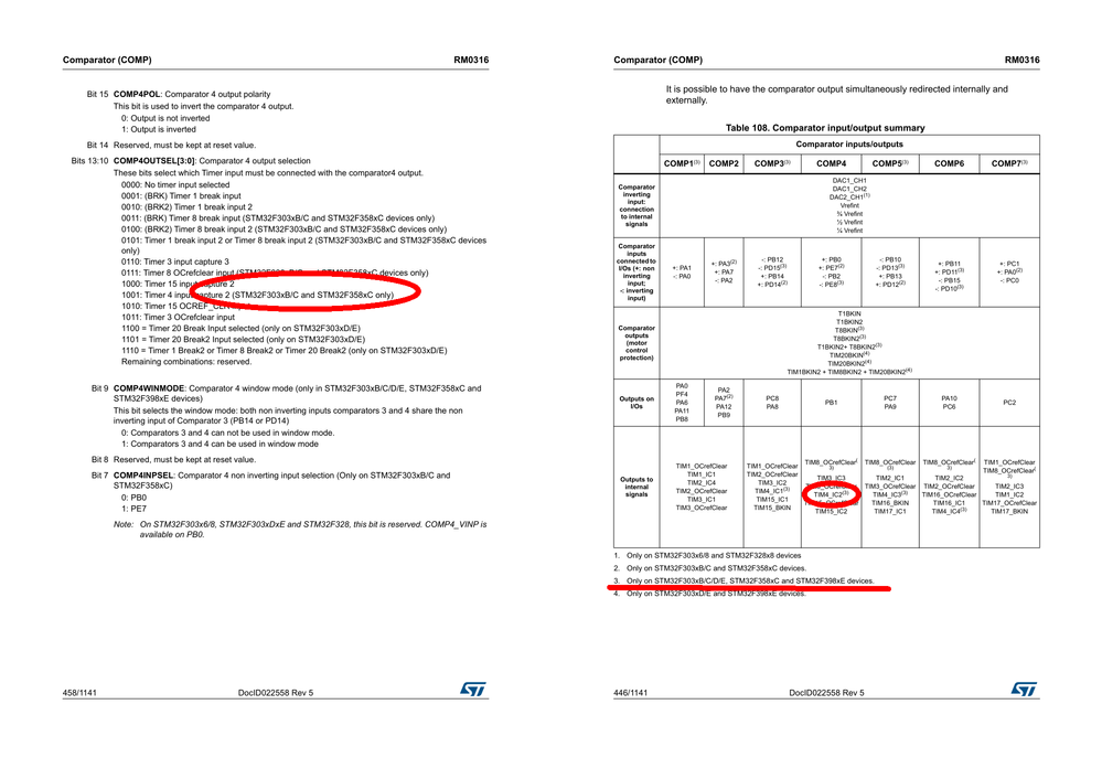

Maybe TIM2_CH4 is unavailable in the 'F303xE. The 'F3 OPAMP and COMP chapters are full of errors.
@Imen DAHMEN , can this please be clarified?
Thanks,
PS. AN4651 is not helpful, it appears to be a verbatim copy of the interconnections chapter which is not helpful either, as the exclusions are not detailed in the COMP-to-TIM table at all.
2020-07-20 3:11 AM
Regarding the RM0316, the contradiction notes have been removed on the latest RM Rev8.
Best Regards,
Imen
2020-07-20 7:39 AM
When I saw this I got my hopes up .... but I'm already using RM0316 Rev8. Still can't seem to get COMP4 to run TIM4_IC2. Yet can get external GPIO to run TIM4_IC1 or TIM4_IC2. Also, I do see COMP4 on output PB1.
Nice to know my RM0316 Rev 8 is latest copy though, thanks !
2020-07-20 11:38 AM

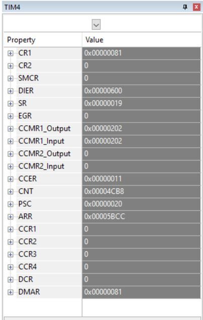

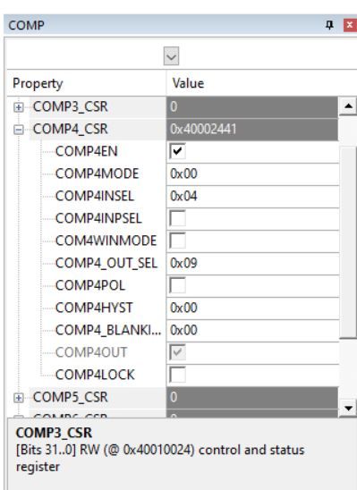

2020-07-20 12:58 PM
Hi ,
I'm attaching snapshots of COMP4 Reg and TIM4 Reg,
2020-07-20 3:14 PM
This all looks reasonable, the channels' crossing is a bit weird but that's probably the experiment you've described in your initial post.
Also, you have DMA enabled on both CC1 and CC2, why's that? Is there any difference if you don't enable that DMA?
Please double-check in GPIO registers that you don't have any TIM4_CH2 input enabled in the GPIO matrix (PA12, PB7, PD13 - please check GPIOD even if that pin is not present on your package).
As a test, can you please try to use another timer, e.g. TIM15_CH2?
2020-07-20 4:50 PM
I'll need a day to get back to this. But for now, I did disable the DMA on both CC1 and CC2 with no change. The reason I am using these is I am capturing the TIM4 count for both Ch1 and Ch2 and using this to compute a phase error. I'm running a motor and will be using the phase error between Ch1 and Ch2 to modify the speed command to align the two edges together.
You're right the channels were crossed as a result of my previous test
I will double check the GPIO registers and try another timer as well.
Thanks,
Brian
