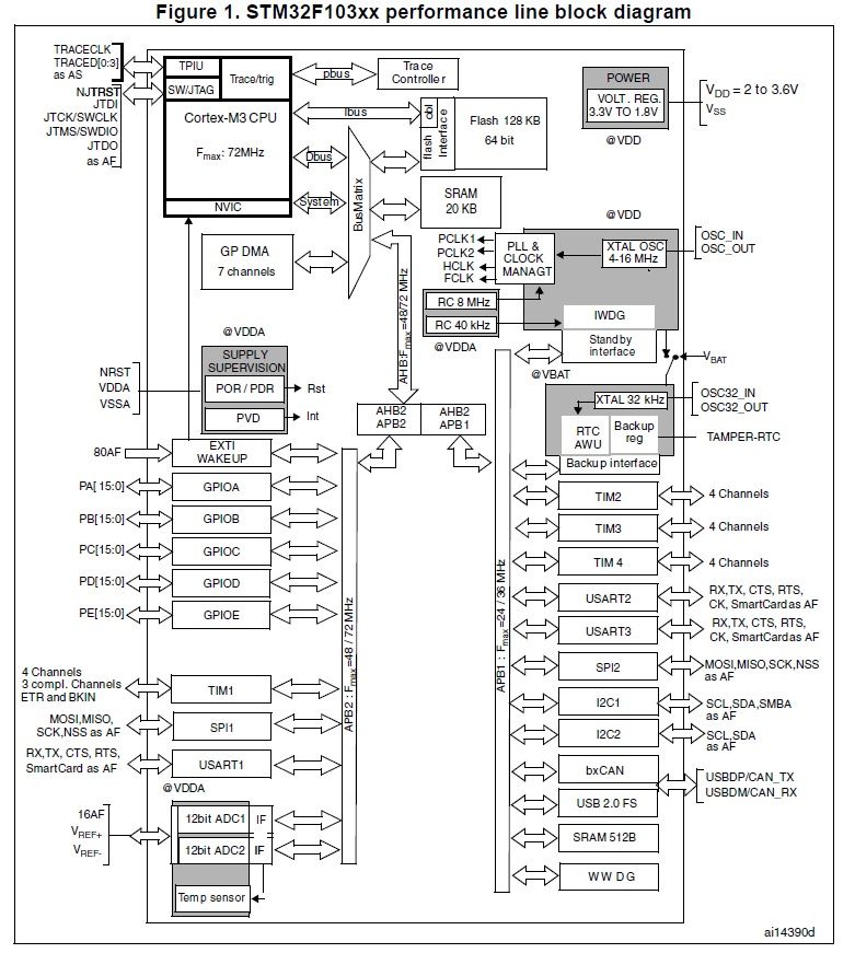

I will repeat my question, the different registers use for CAN communications are obviously stored onto the STM32 card, but where ? Thanks for the help,Nicolas
2017-06-14 11:14 AM
They are in a big block of IP that represents the CAN Peripheral.
The Cortex-M3 is just the processor core, it is surrounded by very large peripherals composed of tens-of-thousands of logic gates (or equivalents). The F1 design has a block of RAM used by the USB and CAN peripherals.
2017-06-14 11:21 AM
The processor is in the bottom right corner, the unorganized mass of gates in the middle is the peripherals
2017-06-14 11:28 AM
This is the diagram from the Data Sheet, the CAN stuff lives inside the bxCAN block and the SRAM 512B block, lower right corner
