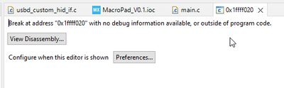

Also, when i create the programm, i have this kind of error
do you know what could be the source ?
2024-12-18 12:38 PM
Hi all, for the last error, seems an issue with BOOT0 but do not seem to have any issue with the programm.
