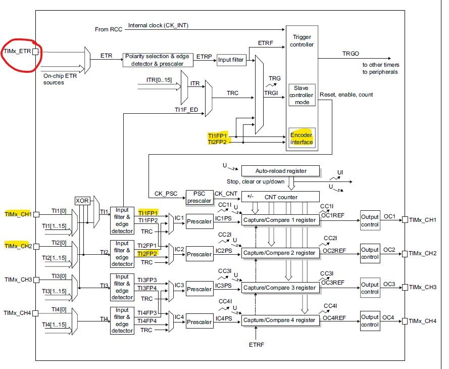

I am designing a board and would like to use the 32 bit timer (TIM2) in encoder mode. Per the block diagram in RM0444:
the inputs to the encoder interface are T1FP1 and TI2FP2, which originate from TIM2_CH1 and TIM2_CH2 (highlighted in yellow). It appears that the TIM2_ETR input is completely unrelated to CH1 and CH2 inputs.

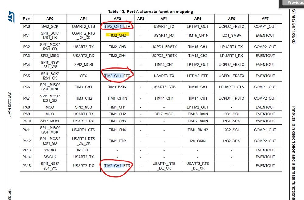

However, in the STM32G0x1 data sheet alternate functions table, I see:
Note, TIM2CH2 is available on pin PA2, and TIM2_CH1_ETR is available on multiple pins (PA0, PA5, PA15). But... which is it? TIM2_CH1 or TIM2_ETR? How can it be both?
I reference register TIM2_AF1 (p. 694 of RM0444), and there are a number of different ETR sources - but none are TIM2_CH1.
What am I missing?
Input from that pin is simply connected to both the ETR and CH1 inputs of the TIM module.

Thanks for the prompt response. To confirm, the RM implies that external trigger and encoder modes are mutually exclusive (per SMS bits in TIMx_SMCR). So if I connect my external encoder signals to PA0 (TIM2_CH1_ETR) and PA1 (TIM2_CH2), I should be able to configure the registers to enable TIM2 (32 bits) to act in encoder mode. Is that correct?
2022-07-06 5:23 AM
Yes.

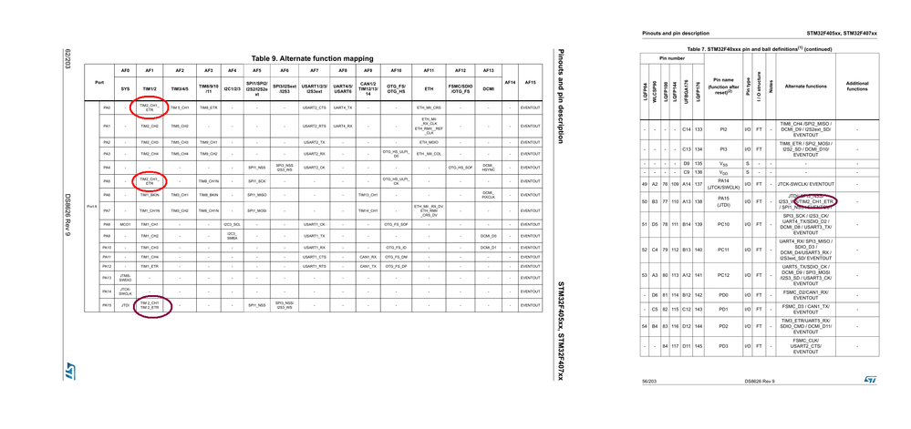

The TIM2_CH1_ETR combination is quite common in all other STM32, too. This used to be a recurring question one time. The DS used to marke these pins more sanely, but then ST somehow messed it up completely.
An entirely random selection of related threads (you can find more if you want):
https://community.st.com/s/question/0D50X00009XkgkeSAB/stm32f407-tim2ch1etr
https://community.st.com/s/question/0D50X00009XkZNISA3/where-is-tim2ch1-on-the-stm32f4-chips
