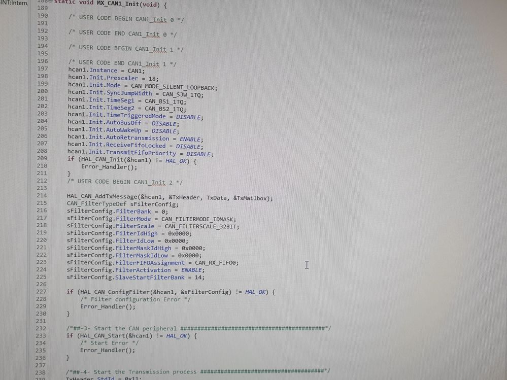

I intend to use CAN module in STM32F722ZE Nucleo board, but I have a problem- the CAN module does not work.
I tried to see the example code, but it also is not run.
Anyone has the source code for CAN module in STM32F722ZE Nucleo? ( Loopback or normal mode)
Thank you so much

I'm wondering why you're using 18 as CAN prescaler and value 1TQ for BS1 and BS2?
Could you please decrease the prescaler and increase BS1 and BS2 to match your bitrate, then test again?

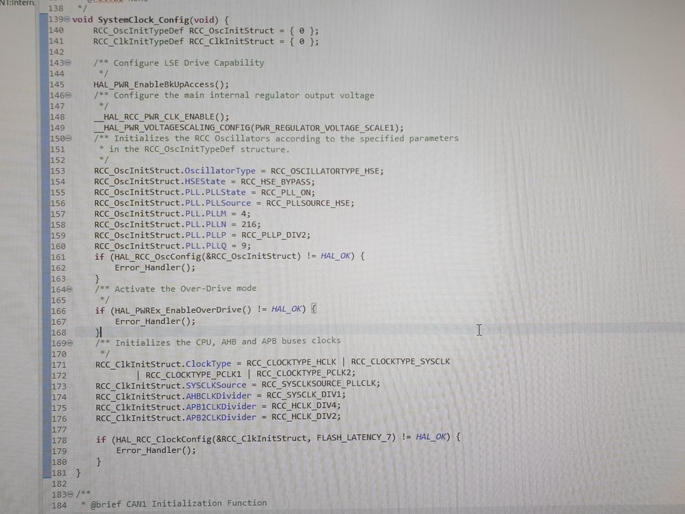

2022-03-07 12:08 AM
Post configuration clock and can.

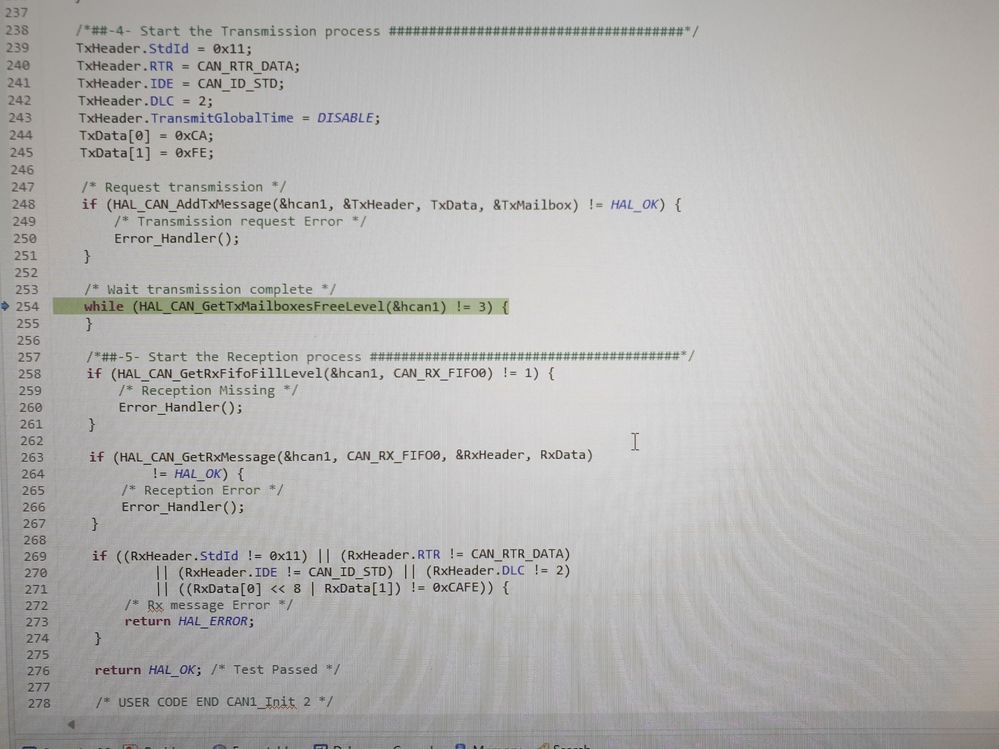

2022-03-07 2:19 AM
I am using the Loopback mode to test the code for CAN module. The pointer is also passed through "HAL_CAN_AddTxMessage(&hcan1, &TxHeader, TxData, &TxMailbox)!= HAL_OK; "
But, the program is looping at "
/* wait transmision complete*/
while(HAL_CAN_GetTxMailboxesFreeLevel(&hcan1)!= 3)
I just use F722ZE Nucleo board, no additional configuration.
I also use STM32 CubeMx to generate the configuration code.
Thank you so much.

2022-03-07 2:44 AM
I also try to copy that project and modify to use F722ZE, but, it isn't successful.
Can you give me a project that work well at F722ZE board?
Thank you so much
2022-03-07 5:39 AM
