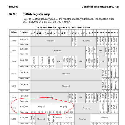

where do i check this counters? It realyy shouldnt be a hardware problem, since the boards i used worked on a previous project. And now i have confirmed, that i recieve data on the RX pin, but there is no data visible on the TX pin, eventhough it shoudl be? (because of the 120 Ohm terminator). Is there a way to recieve CAN data without an interrrupt?
2025-08-20 1:38 AM
But obviously there is.
Besides of the already mentioned termination resistor, you can swap the CAN_H and CAN_L lines on one side, this does no harm to the hardware. And you can try with and without CAN_GND.
