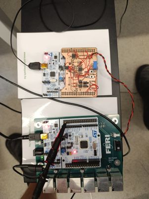

The goal of my project is to turn on an LED on the recieving side through CAN. Both my reciever and transmitter have the transciever circuit. Both are Nucleo boards, TX: F303RE, RX: F446RE.

The reciever board is part of another project, but i used it, since it has the transciever circuit and that way there was no soldering needed. And the reciver board worked on the previous project of my friend.
The boards

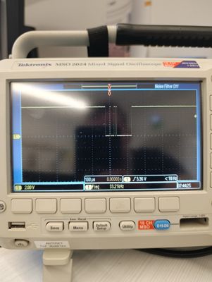

The signal when the RX is not reset:

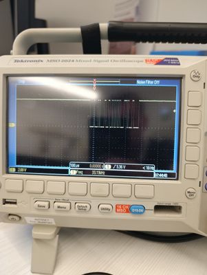

The signal when it is reset:

2025-08-13 3:01 AM
The truncated message is probably because there is an error on the BUS.

2025-08-13 3:12 AM
2025-08-13 4:32 AM
The signal on CAN-H is not ok, You can see the error frame from the RX node, but not the data from the TX node.
Check the connetion between the Transceiver and the cable. If this is OK the You have a broken Transceiver on the TX module.
