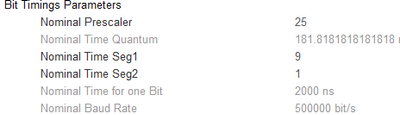

3- I said previously: please avoid 1Tq for TSEG&/TSEG2 timing configuration. Please review my posts above:

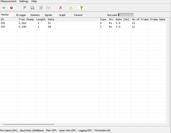

2026-02-12 3:52 AM
You’re right — I apologize for the earlier confusion.
I have now updated the baud rate to 1 Mbit/s on all boards (both G474RE and the H723ZG) by adjusting the clock configuration and nominal prescaler values. To avoid any further confusion, we can proceed with this updated configuration.
I will upload the .ioc files for your review. Kindly go through them and share any possible suggestions or corrections.
Even after changing the baud rate from 500 kbit/s to 1 Mbit/s, the two G474RE boards are communicating successfully with each other, but the H723ZG board is still unable to communicate with them.
Currently, data is being transmitted continuously in a loop. The CAN messages from the G474RE boards are visible on the bus monitor, whereas the data from the H723ZG board is not appearing on the bus monitor at all.

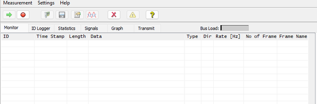

2026-02-12 4:13 AM
... whereas the data from the H723ZG board is not appearing on the bus monitor at all.

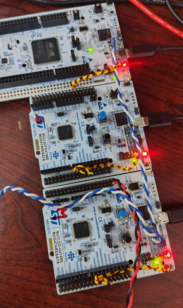

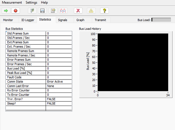

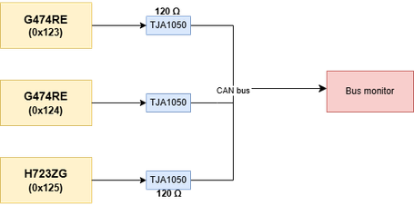

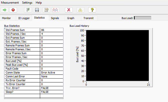

2026-02-12 4:44 AM
I've enabled the bus error display and monitored it with & without the working pair of boards (G474RE).
With the working board setup:
After disconnecting the working board setup:
Hardware Image:
I hope this is clear for you.
2026-02-12 4:55 AM
No not clear yet.
Do you have an oscilloscope or logic analyzer? if yes could you please probe FDCAN_Rx pin from STM32H7 side?
Please don't change the bitrate or anything else while we are analyzing the issue, you complicate things..
The photo doesn't show the interesting parts: the transceiver etc ..
