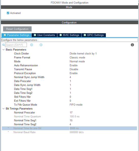

I am trying to establish CAN communication between three different MCUs: NUCLEO-H723ZG, NUCLEO-H755ZIQ, and NUCLEO-G474RE. However, I am unable to successfully communicate between the boards, even though the same baud rate has been configured on all MCUs. I have also connected an external CAN transceiver to each board for proper CAN bus operation.
On the NUCLEO-G474RE, I have enabled UART4 to send command data, using the following pins:
PC11 – UART4_RX
PC10 – UART4_TX
Clock Frequency [SYSCLK] & Baud Rate [CAN]:
1. NUCLEO-H723ZG: 550 MHz
Baud Rate: 500000 Bit/s
2. NUCLEO-H755ZIQ: 480 MHz
3. NUCLEO-G474RE: 170 MHz

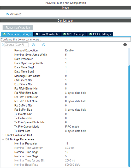

2026-02-10 7:38 AM
> That's a bad configuration.TSEG1 =TSEG2 = Tq!
... and giving an interesting nominal bit rate of 5 Mbit/s :D
Which might be an interesting experiment if the STM32 can handle this. But TDC should be enabled.
2026-02-10 7:41 AM
LOL! nice catch. I didn't notice that. I saw it 500kb/s.. Classic mode @5Mb/s :D

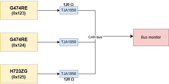

I have connected three MCU boards on a CAN bus with proper termination using two 120 Ω resistors at each end of the bus, resulting in an effective bus resistance of approximately 60 Ω. The grounds of all boards are connected together.
The three boards used are:
NUCLEO-G474RE (2 boards)
NUCLEO-H723ZG (1 board)
Each MCU board is interfaced with a TJA1050 CAN transceiver for CAN communication.
I am using STM32CubeIDE version 1.19.0 and have flashed the CAN firmware onto each board. An external CAN bus monitor/analyzer is connected to observe the CAN traffic.
I am able to successfully monitor CAN data from the two G474RE boards (the data is attached below), but I do not see any CAN messages from the H723ZG board on the bus monitor.
All boards are configured with the same CAN baud rate of 500 kbit/s.
G474RE Board 1: 0x123
G474RE Board 2: 0x124
H723ZG Board: 0x125

How you establish the communication in the H723ZG board?
