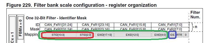

2019-11-07 5:08 AM
Perhaps set IDE value appropriately?
2019-11-07 5:41 AM
Thank you for your reply, if i change the IDE to CAN_IDE_EXT then it doesnt receive the StdID value. is there a way to receive both?
Kind regards,
Mike
2019-11-07 5:49 AM
2019-11-07 5:52 AM
It is a bit saying how many bits are in the ID, and where they are packed in the frame. It has two states and one of them isn't Ambiguous.
Should be a diagram of the packet frame on the wire, take a critical look at that.
2019-11-07 5:58 AM
The filter gives you all the packets, look at how you are decoding and unpacking them to extract the detail you actually want. For example identifying the ID type flagged and using that form, or truncating to get the smaller bit count value masked out.

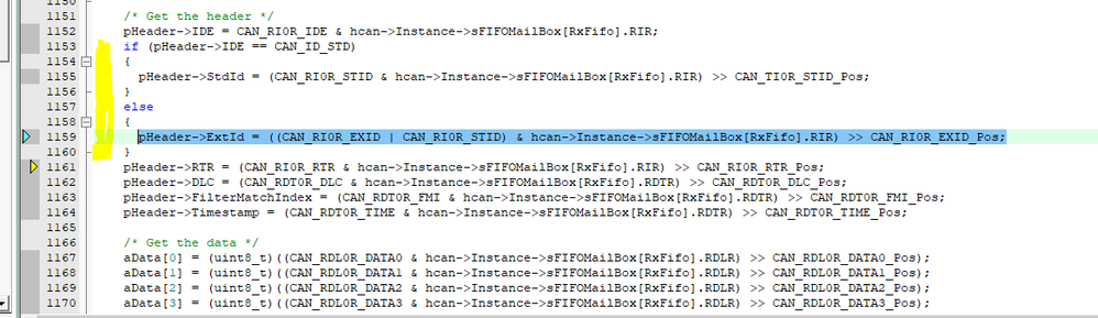

2019-11-07 8:02 AM
Hi, I have stepped into 'HAL_CAN_GetRxMessage' in debug from the cubeMX code and it suggests that you can do Std or ExtId from the 'if' statement - correct me if im wrong
2019-11-07 8:28 AM
Like I said, it is one or the other, there isn't this third ambiguous choice you seem to allude too.
They share common bits on the wire, the Std Id is 11 bits, the Ext Id is 29 bits, one is a SUBSET of the other.
The library encodes/decodes either StdId or ExtId structure values into the STID and EXID bits in the packet frame, along with the IDE bit to determine which is being communicated.
