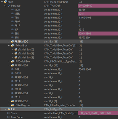

That is precisely my doubt. Putting aside my use case, I expected the hcan to go into error state or hcan->ErrorCode to show a non zero value. But neither of these happened - I verified by monitoring the hcan instance in live expressions.
In my code, I have enabled notification for CAN_IT_ERROR_PASSIVE and CAN_IT_BUSOFF, but the HAL_CAN_ErrorCallback never executed - even after I pulled out the transceiver and waited for 5 minutes. At no point, did HAL_CAN_AddTxMessage return anything other than HAL_OK, even though the hcan was clearly not transmitting anything. Of course, transmission starts right back up if I enable automatic bus-off handling during init, but that is really not the point here.
Did I maybe get the callback wrong or have I misunderstood the hcan API?
Screenshot of the hcan state after I pulled out the transceiver for reference.

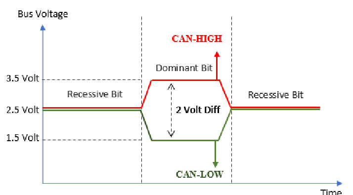

You can't do that for the transceiver self test. Again this is not what CAN interface is intended to be used. You need another CAN node on the bus to make that function consistent (CAN in Normal mode).
If you need to develop a self test on the transceiver may be to apply Low an High on the Tx transceiver pin and use two ADC channels and measure the voltage of recessive and dominant voltage levels on CAN_H and CAN_L pins of the transceiver. Or add a comparator to detect the differential voltage on CAN_H/CAN_L. I don't know if it works but need to test it.
I don't see another method for your scenario. And please discard the usage of the CAN interface for that purpose.
