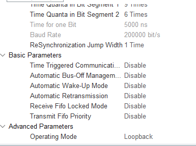

2024-02-14 1:21 AM
Attached a project using NUCLEO-L433RC-P on which CAN1 is configured in loopback mode.
Details:
But be careful, here, HSI has been used as system clock because loopback mode is used. So the timings / jitter are similar on transmit and receive. But when you switch to Normal mode to communicate with another board you need to use HSE with a crystal as source of clock.
Hope it helps.

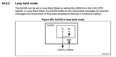

2024-02-12 5:08 AM - edited 2024-02-12 5:11 AM
In loopback mode Tx and Rx pins are automatically tied together internally by HW:
Please refer to the reference manual RM0394.

Ok yeah I understand now why a transceiver isn't needed. My point of using a oscillator was to check if a CAN-signal is being sent out (since when I click the resume button I lose the possibility of looking at the values in TxHeader and RxHeader. But I guess since I can't look into them it means a signal isn't sent out. How should i do the hardware part then? Just connect the rx-pin to the tx-pin?
2024-02-12 5:58 AM - edited 2024-02-12 5:58 AM
Look..
As I said, No need to connect Rx and Tx pins in loopback mode as are already connected together internally in this mode. Look at the figure I shared previously.
If you need to check the CAN frames output using an oscilloscope, the answer is: yes you can. Probe on Tx pin.
Hope it's clear.

You can look at the TX pin whilst in Loop-Back mode, the Rx pin will be internally disconnected as this is looped-back instead.
The baud rate via the prescaler and segment timings will be non-critical as they will implicitly match in loop-back.
