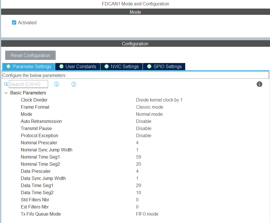

Hello seppeltonics_v and all,
I got this working. I had to figure out how the bit alignment of the extended ID CAN 2.0 with their FDCAN_RxHeaderTypeDef as we use the protocol slightly different from typical.

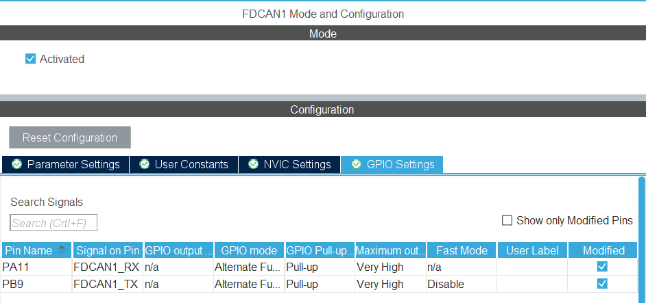

this is what I have used, at least it spit out a CAN-Frame. Please also check the IO-Setting, you may have to go to the GPIO-Setting, the IO-Pin-Speed may be an issue as well, I set them to "very high" and "pullup", I would also recommend "Fast Mode", if you got EMI issues, you can play with it later.
Best Regards, Seppeltronics

Yes, thank you it's working. I successfully configured CANFD to work as CAN 2.0.
