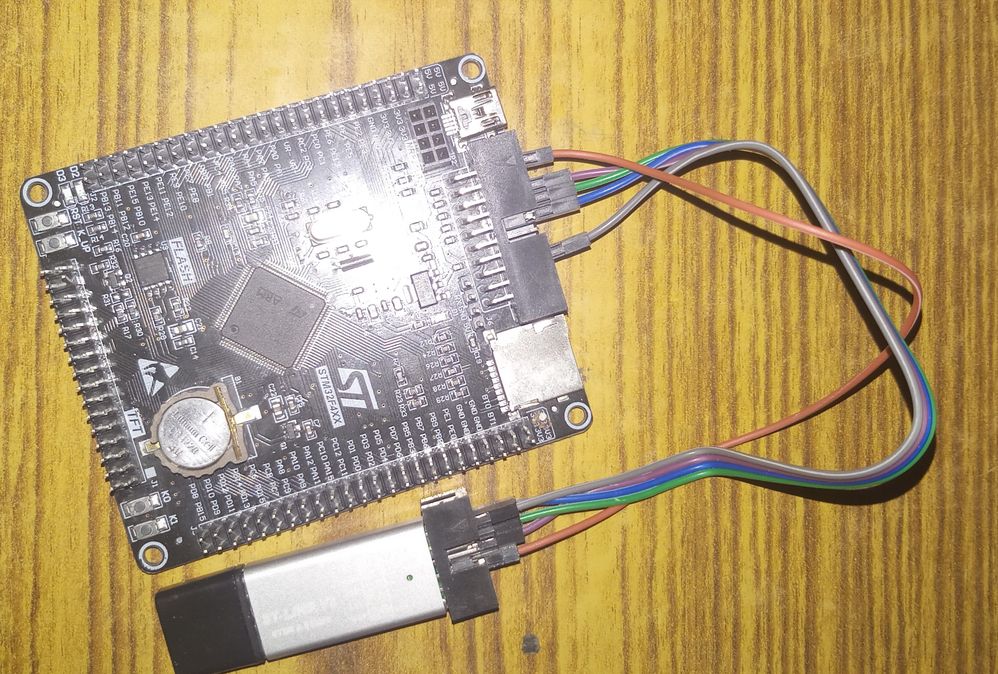

I recently bought a STM32F4VE board. I have experience in 8051. Im unable to learn program the STM board on Keil. Its completely different compared to 8051. Im completely confused.

I downloaded Keil MDK v5. Im using an ST Link v2 programmer for programming the board. I have downloaded the ST link utility software and necessary software. But I just find even the simplest program very complex. How do I learn to program the ARM cortex from scratch?
