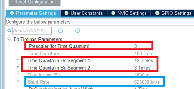

These are bad config for CAN bitrate:
hcan1.Init.TimeSeg1 = CAN_BS1_1TQ;
hcan1.Init.TimeSeg2 = CAN_BS2_1TQ;
Need to increase BS1 and BS2 and decrease the prescaler as much as possible in such way BS1 =~(75% to 85%) of (BS1+BS2).
Example with bitrate @625kb/s with a sampling point at 80%: prescaler =3, BS1=12, BS2 = 3.

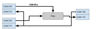

I am trying to get data from the CAN port and store it in a Tx FIFO that USB service reads from periodically to transfer data to the computer. Also I want to store the data received from USB in the Rx FIFO and the data CAN peripherals can read from periodically.

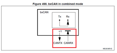

I wish to ask how I can simulate the triggering of CAN_IT_RX_FIFO0_MSG_PENDING interrupt that will call the HAL_CAN_RxFifo0MsgPendingCallback ISR. I have added the code to save the data gotten to from the CAN Rx FiFo to the USB Tx fifo but can't really test it without proper CAN device to connect to the peripheral
Here, I can suggest to use CAN in combined mode so the CAN cell is totally disconnected from outside the chip: no HW dependency.

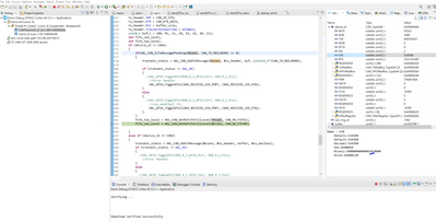

2024-04-11 11:31 AM - edited 2024-04-11 11:41 AM
I have activated the combine mode
But I get the Bit dorminate error when In try to transmit and no Rxfifo pending message callback, I guess beacause
CANTX is being held receive in this mode. I still don't understand why I don't get the CAN RxFiFo interrupts

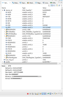

2024-04-12 3:36 AM - edited 2024-04-12 7:44 AM
