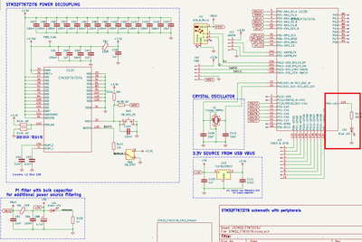

Yeah, sorry not familiar with your board design, attach schematic or portion thereof

Sorry, below is my schematic for stm32. I marked LED that I was talking about with a red box.

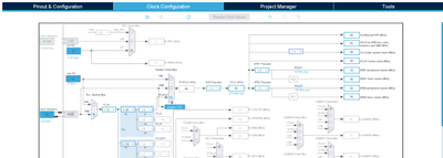

This is my clock config. I tried using HSI and result is the same.

Nothing immediately jumping out from the schematic as problematic
