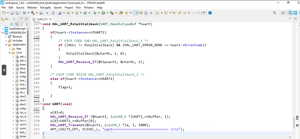

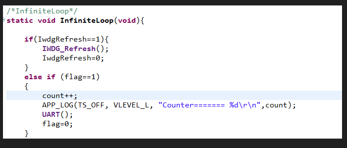

--> I put a flag in RX complete call back function and I check the flag in while loop and also I set increment count in while loop.

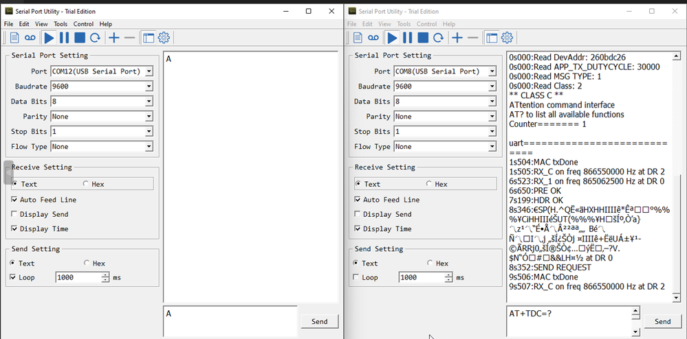

Result:
After reset the device that time only UART1 interrupt is triggered. Below I have attached the screenshot
And also I have set the same priority in LPUART1 and UART1 its not working
set flag in RX complete call back function:
Serial Monitor:

Use the debugger to set some breakpoints and see what is happening.
Single step through the code if you have to.
