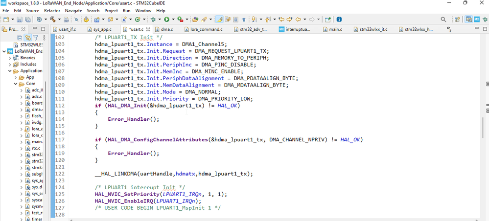

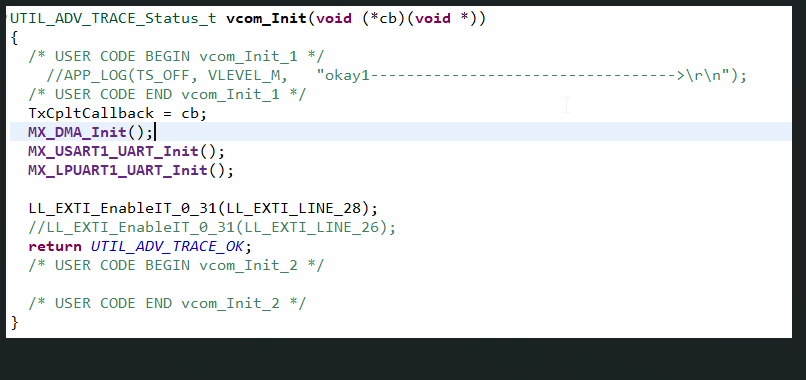

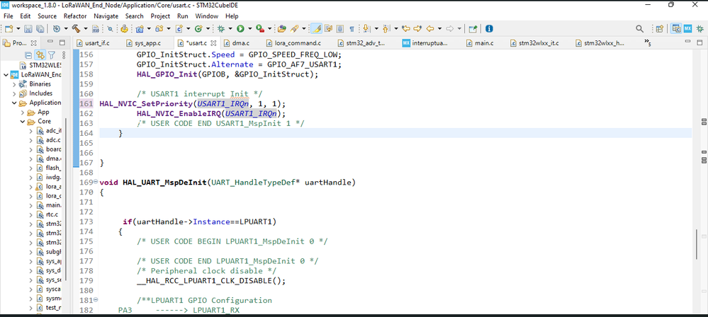

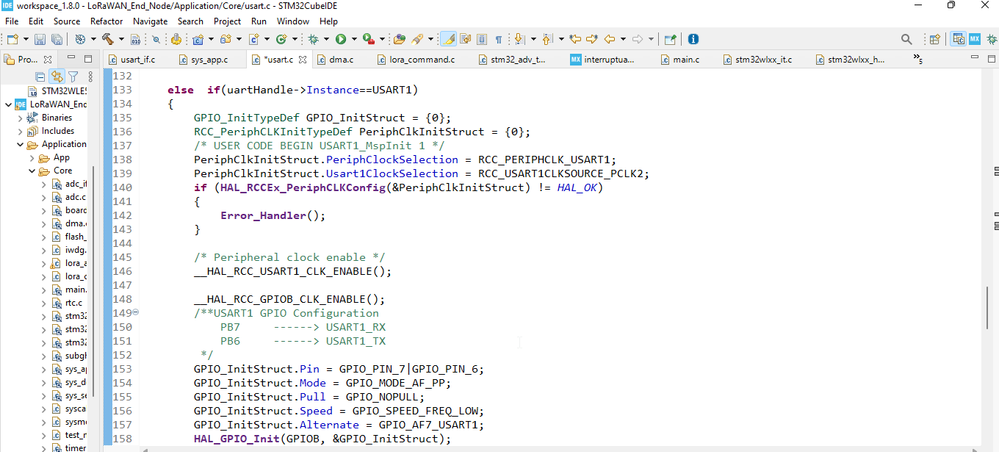

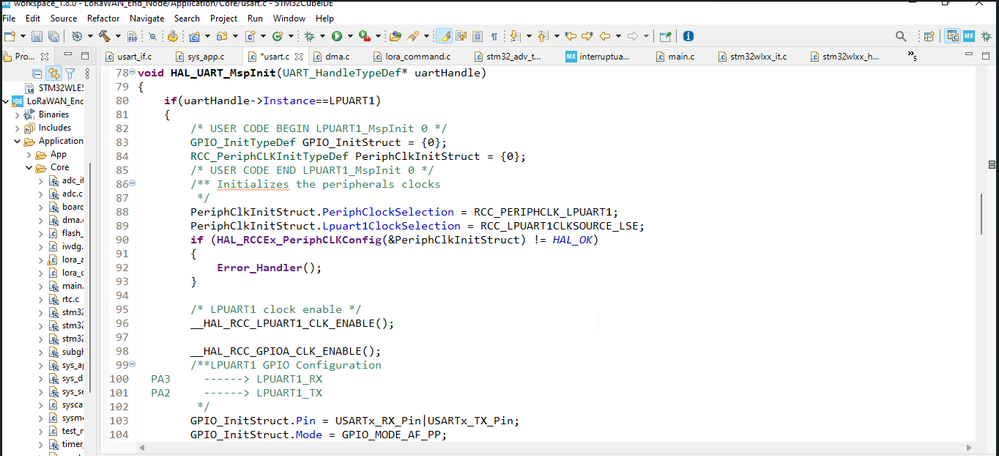

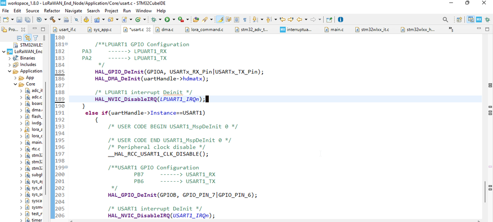

Currently I am working in Uart interrupt in along with LoRaWAN in RAK3172 module(STM32WLE5JC MCU).
I had worked with 2 UART interrupt without LoRa its working fine which was generated in STM32CubeIDE.
while trying to integrate one Uart interrupt with another LPUART interrupt which was used for AT commands configuration in LoRa its not working.
Below I have attached the Configuration Screenshot step by step
Kindly support for rectify this issue.

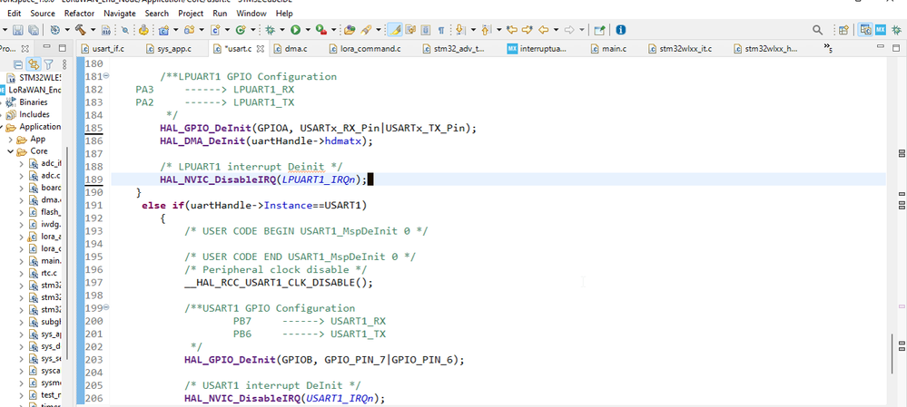

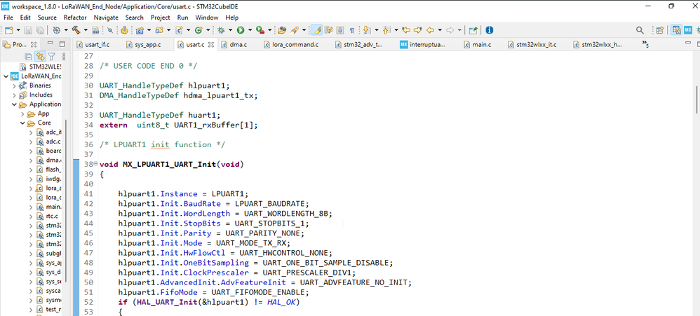

2022-12-06 9:56 AM
Step 1: LPUART init function
Step 2 : UART1 init function
Step 3: Uart Msp init
STEP 4 : UART MSP Deinit
2022-12-06 10:01 AM

2022-12-07 1:09 AM
@Community member
I have changed the NVIC priority in LPUART1 (PreemptPriority, sub Priority-->(1,0)) and UART1 (PreemptPriority, sub Priority-->(2,1)) still now I have facing same issue
