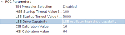

but : first set LSE drive level high ! then use cap size, matching the data of your crystal. then check deviation again.

in cube:

ad said by @AScha.3 This Crystal is with CL=9pF and good pullability level if you have a good PCB Cs ( parasitic capacitance) should not exceed 3 to 5pF so CL1 and CL2 should be in range of (9-3 ) * 2 = 12pF and (9-5) * 2 = 8pF . You need also to activate by software the High driver level as by default after Power up / backup domain - it is set to low drive mode .
Hope it helps you .

Try to bypass the timeout just for debugging and read back the drive level by software to check the register if really set to high drive mode . If not power off and then On the device .

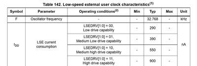

Are there some calibration or tuning values for the LSI ? More coarsely you have to get the appropriate prescaler and divider value in the RTC. The frequency typically isn't 32.768 KHz like the crystal.
fLSI is described in the data sheet typically 32 KHz, but can be 29-34 KHz across temperature and voltage
If LSE isn't starting in the prescribed time you'll need to adjust the capacitors so it starts and is close on frequency.
The values suitable of 6, 9 or 12 pF crystals will be different. And you need to account for the properties of the circuit.
