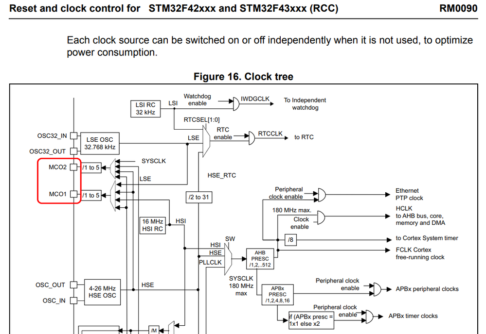

Timer settings seems to be right. Have you done clock configuration in CubeMX? Please check if time clock (APB1 Timer clocks) is really 72 MHz.

@Ash1 If in doubt, route the clock to one of the MCO pins, and measure it; eg, on an oscilloscope.

Sounds like you're clocking at 100 or 108 MHz, not 72
Check your PLL and HSE relationships
