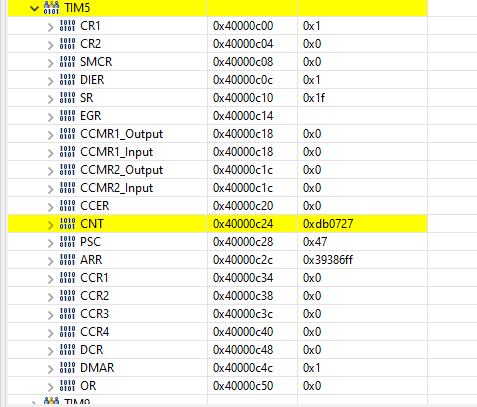

I am trying to run timer5 create interrupt for one minute .
I have loaded 59,999,999 in ARR register and 71 in pSC prescaler register is it correct?
I am sharing you screenshot of tim5 register at runtime but my timer is expiring at 50(approx.) second I have loaded prescaler and ARR as you said.
note: instead of one minute it is expiring before that...also I have configured CKD in (TIMx_CR1) as 00 is it correct too
Here is the screenshot - pasted into the post for easier viewing:
