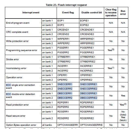

I am wondering if a BusFault is triggered when a double error is detected but the Flash IT (or the DBERRECC event) is not enabled ?
