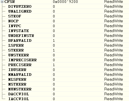

I am currently working on a project using STM32U575 with Trust Zone activated.
I am using IAR compiler.
I am facing an issue where Bus Fault is triggered whenever a PUSH isntruction is executed during the call to a cmse_nonsecure_entry function
BFAR address value is always this random 0xffff xxxx value (e.g. 0xffff'fff8 or 0xffff'fffe)
The PUSH instruction is always in the disassembly whenever the entry function calls another function which also exist in the Secure region. If no call to a Secure region function is done and only basic operations are there, the entry function works fine and no bus fault occurs.
What seems to be the problem here?
