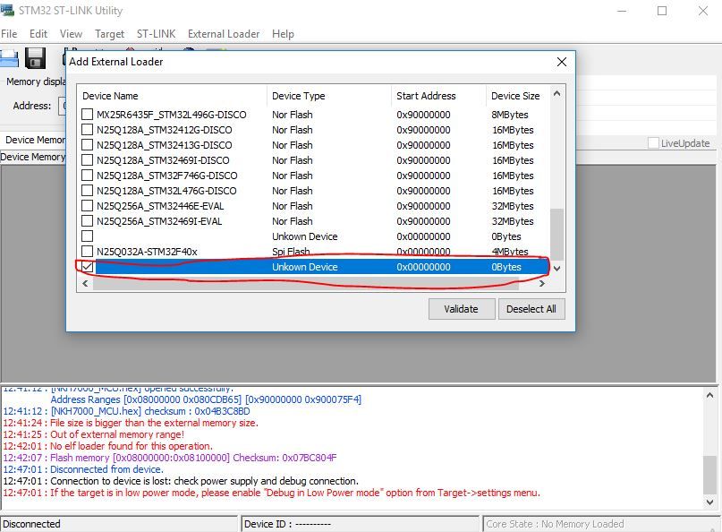

Hi , I have same problem. I am going to program w25q128FV from ST-Link with custom stm32f746bg board.
I used N25Q256A_STM32L476G-EVAL example in installed ST-Link software. but .stldr file generated with this example does not correctly identify with ST-Link.
why??
2017-06-19 6:49 AM
Hi nahvi, at the beginning, I have the same problem
. Then I used the old iar 7.4 to compile the example. The
.stldr file can be identified correctly by ST-Link Utility, but not sure the functions are OK. I implemented a program loader of N25Q064A with custom stm32f746ng board. It can be identified but functions are not working. and I am still struggling with it.

Thank you, I already implemented the qspi serial flash loader, everything works well. So the only issue is ST-Link Utility can NOT recognize the loader generated by new IAR (I tried 7.70.1, and 8.11.2)
