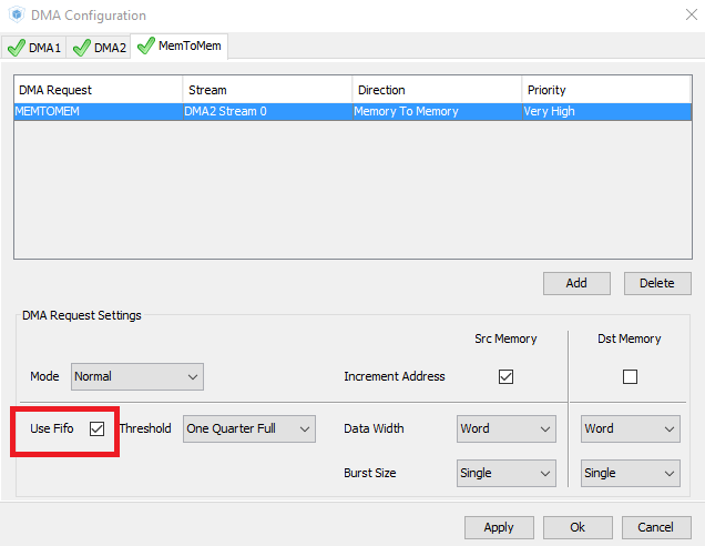

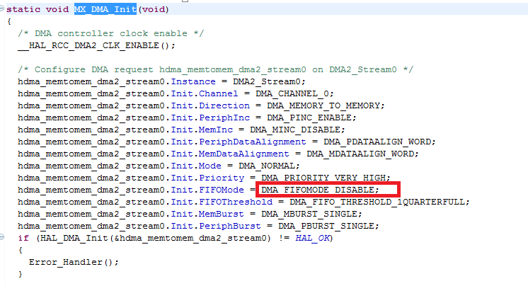

Using CubeMX version 4.16.0 with DMA it does not let you turn off FIFO mode. The check mark does not deselect.

The CubeMX is used to generate code for the STM32F767 Nucleo Board. Same issue was seen when it was used for STM32F746 Nucleo Board.
