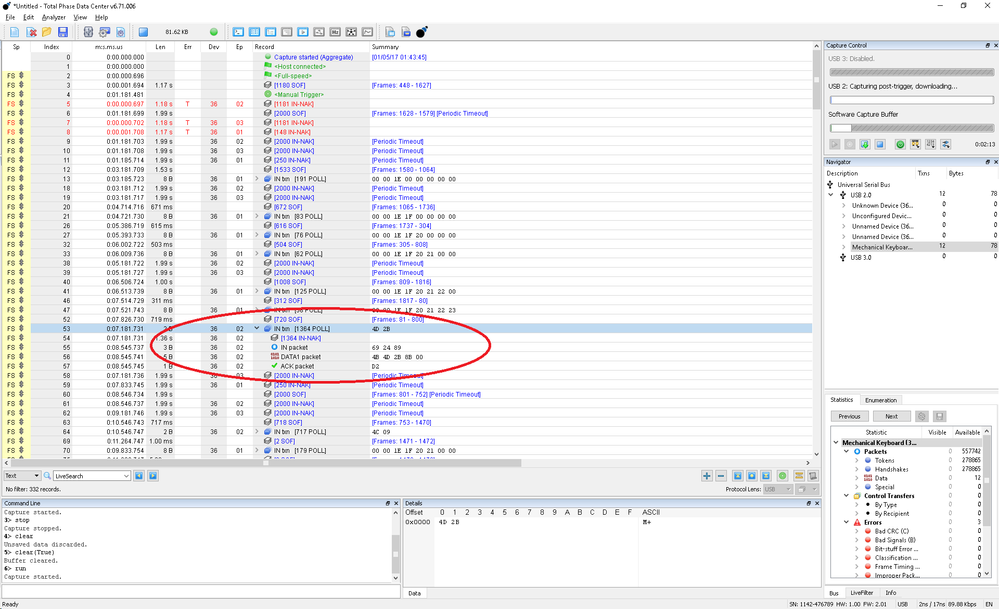

I have the same issue it seems, It is very serious. Debugged this for quite a while until i found this post here.

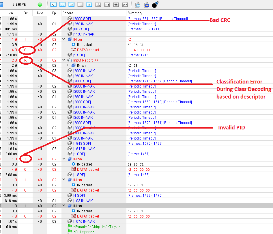

I amalso getting bad transfers on EP2 (and possibly any of the higher EP1 above 1) and have it traced down to exactly this function to be called with the correct data being supplied. 16 Byte Buffer is defined but only 2 reach the PC and it is totally wrong data. Sometimes the Beagle 5000 reports bad CRC as well. EP1 is all ok.
Here is what I see in the USB Analyzer:

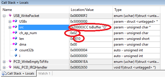

This is what is called:
USBx_DFIFO(ch_ep_num) = *((__packed uint32_t *)src);�?
And here is the Route Call Stack just before the sent:
And Finally here is the Buffer to Send:
For the Report descriptor it is fine, it works on many commercial products we did.

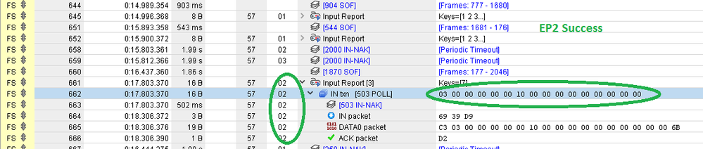

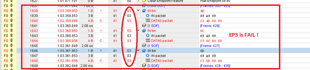

If I try the same thing via EP3 it also fails:

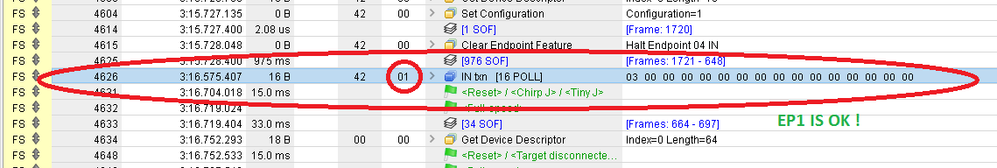

But if I specify EP1 in my send routine (illegally, of course just for test) :
At this point I have serious doubts, it is not the user code, but either it is something not setup correctly in the LIB when opening the higher EP (I did have to set the TxFifo Manually) or it is something in the USB Engine itself that goes wrong.
