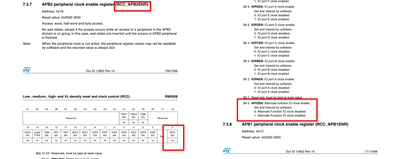

1-Now I know how it works, it is diffcult to know without you answer, learn a lot.
so you can disable it by setting AFIO_MAPR2.FSMC_NADV (don't forget to enable AFIO clock in RCC before writing to its registers).
2-I try this way , but FSMC_NADV bit cat write to True, so PB7 always pullup when FSMC clock Enable.
2025-11-13 6:41 AM
Do you have AFIO clock enabled in RCC?
2025-11-13 6:56 AM
Sure.

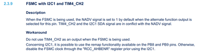

2025-11-13 8:45 AM - edited 2025-11-13 8:48 AM
Interesting. I didn't know about this erratum.
It should apply only to STM32F103xC/D/E (see STM32F103xC/D/E errata) - as you said you have the 'F103ZE, that unfortunately applies there.
It appears that according to e.g. the larger STM32F103xF/xG errata, the problem has been fixed in those chips. I understand this won't help you with that particular board, sorry.

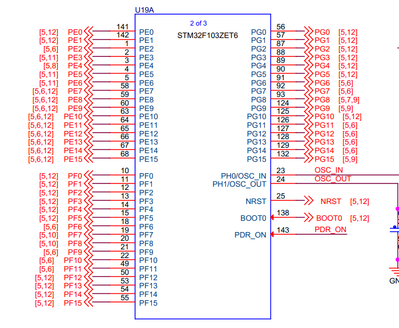

I have checked my chip, it is STM32F103ZET6 same as the schematic, and checked it on the chip (forgot to post),
because I download the STM32F103xF/xG errata first.
