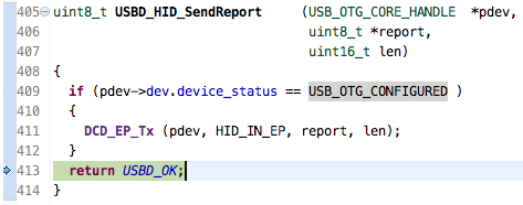

I gathered my guts to try and run the application in debug mode again, set a breakpoint where the HID report is being sent. The code calls USBD_HID_SendReport, but, as per the image below, the *if (pdev->dev.device_status == USB_OTG_CONFIGURED)* block never executes, the function just returns *USBD_OK*

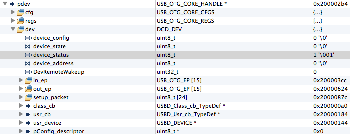

Looking at *pdev->dev.device_status* a bit deeper, reveals the following:
The device status is 1, which matches USB_OTG_DEFAULT, which is one value of four, defined together amongst:
#define USB_OTG_DEFAULT 1#define USB_OTG_ADDRESSED 2#define USB_OTG_CONFIGURED 3#define USB_OTG_SUSPENDED 4
Does this mean anything to anyone? I'm not too much of a guru here.
