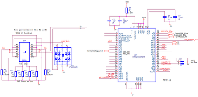

Maybe show schematics , seems some hw fail on your pcb
CWedg.1
Associate III
CWedg.1
Associate III

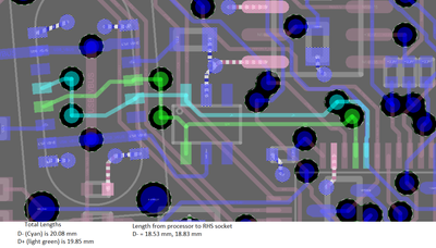

USB socket and processor are within 30 mm, D+ and D- both have 2 or 3 vias. We have tried remove the IP4220CZ6 and behaviour did not change.

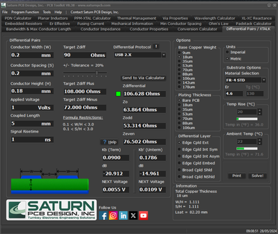

D+ D- is USB differential pair must meet wired impedance and length minimum difference on pcb...
CWedg.1
Associate III
Impedance could be improved, but I believe this should be sufficient for FS (12 MHz) performance. Total distance is less than 25 mm.
