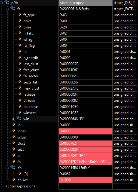

It returns that value from the function static FRESULT dir_next(DIR *pDir, BOOL bStreach)
At this point:
wi = pDir->index + 1;
if((wi == 0) || (pDir->sect == 0)){ //Report EOT when index has reached 65535 return FR_NO_FILE; //Hitting here }This is pDire when I hit the
FR_NO_FILE in the code shown above.
