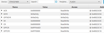

I can check the FLASH peripheral registers via STM32CubeProg, and they all look OK.

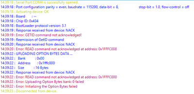

However, when I reset my board with BOOT0 set high, and attempt to connect via UART, I get this:
I also get four popup error boxes:
1. Initialising the Option Bytes failed
2. Uploading Option Bytes bank 0 failed
3. READ command not acknowledged at address: 0x1fffc000
4. READ command not acknowledged at address: 0x1fffx008
You can see from the above dump that the Bootloader is operational and connected, but is not responding correctly.

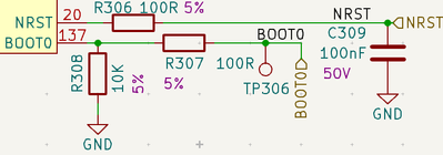

As far as I know, I have configured boot mode selection correctly:
I have grounded BOOT1:
BOOT0 is connected to an external interface:
And to enter the Bootloader, I simply apply 3.3V to BOOT0 and reset the target.
I know it must be in Bootloader mode because you can see it correctly in the STM32CubeProg trace above as Chip ID: 0x434 which I believe has been read from the target?

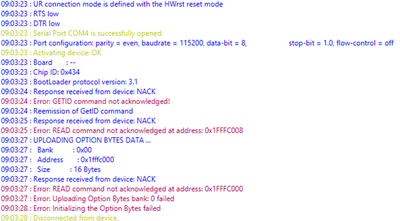

OK, so I just tried it on a brand new PCB, brand new STM32. Never been programmed, so factory fresh:
Exactly the same problem - the bootloader is rejecting the GetID with a NACK...
Chris.
