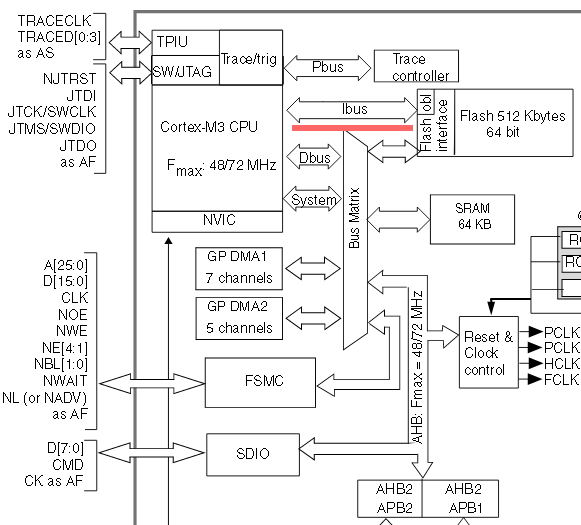

I have a question about the stm32f103xx. I want to know how it boots from Embeded SRAM. I have known that the IBUS of Cortex-M3 can't access the SRAM from the reference manual. When boots from the SRAM, how Cortex-M3 fetches instructions from SRAM?

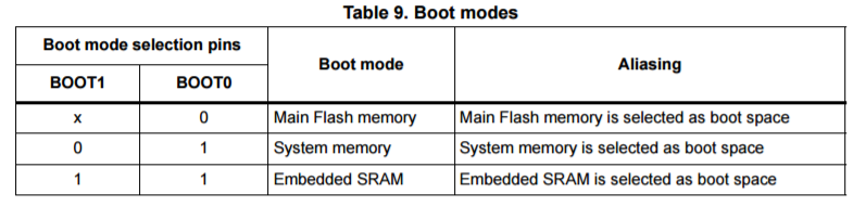

Hi
?,The following table in
describes how to configure the Boot pins to boot from SRAM:-Amel

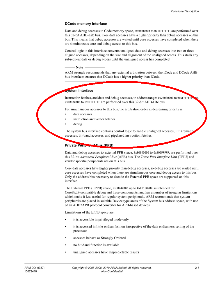

Code can be fetched through S-bus, there's no problem in that.
The tricky part is the reset vector, which have to be at 0x0000004. 'F1 can't remap RAM, and RM0008 mysteriously says ' STM32F10xxx microcontrollers implement a special mechanism to be able to boot also from SRAM'.

Can code be fetched through S-bus? I have looked through relevant documents of ARM Cortex-M3 but I can't find where it is. Could you tell me where you find it? I am looking forward to your reply.

Sorry to disturb, may I don't describe my question clearly.
When MCU starts, CPU needs to fetch instructions from 0x0 to get MSP value and 0x4 to get reset handler through I-BUS.
My question is When booting from embedded SRAM, CPU needs to fetch instruction from 0x0 to get MSP value and 0x4 to get reset handler,
but embedded SRAM is accessiable only at address 0x20000000. How CPU gets MSP value and reset handler when starts from SRAM?
2017-10-24 6:38 AM
Could you tell me which bus the CPU gets the MSP value and reset handler through when booting from embedded SRAM? And why?
