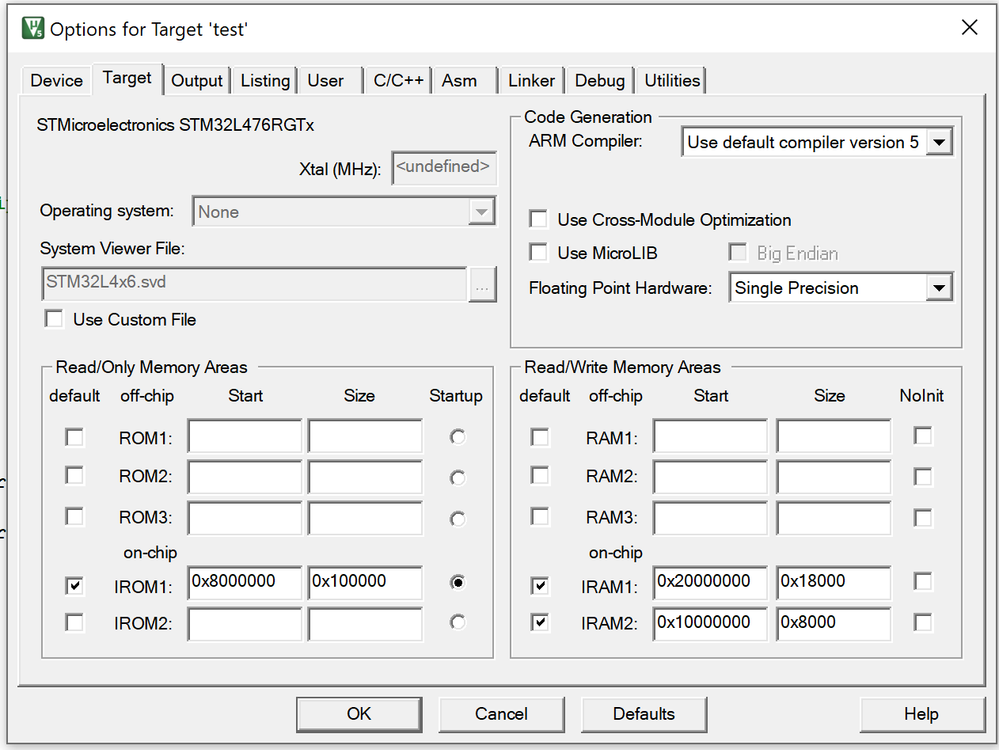

What am I doing wrong here? Attached is the Keil project.

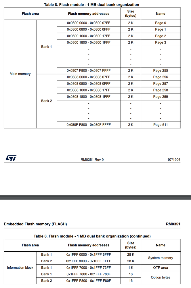

Hey! I know that L0 devices doesn't switch banks but the L476 should. Attached are relevant sections of documentation.

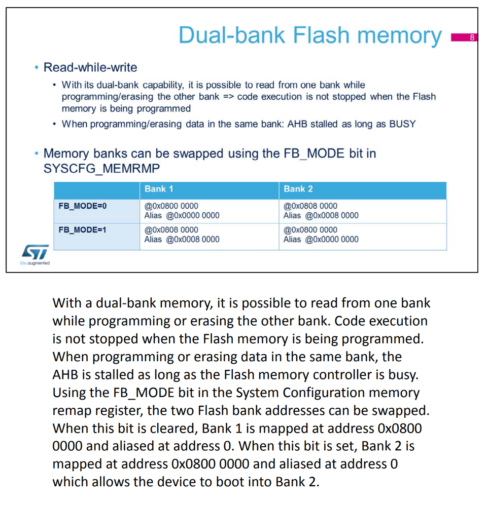

From STM32L4 flash presentation.

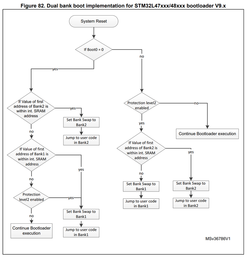

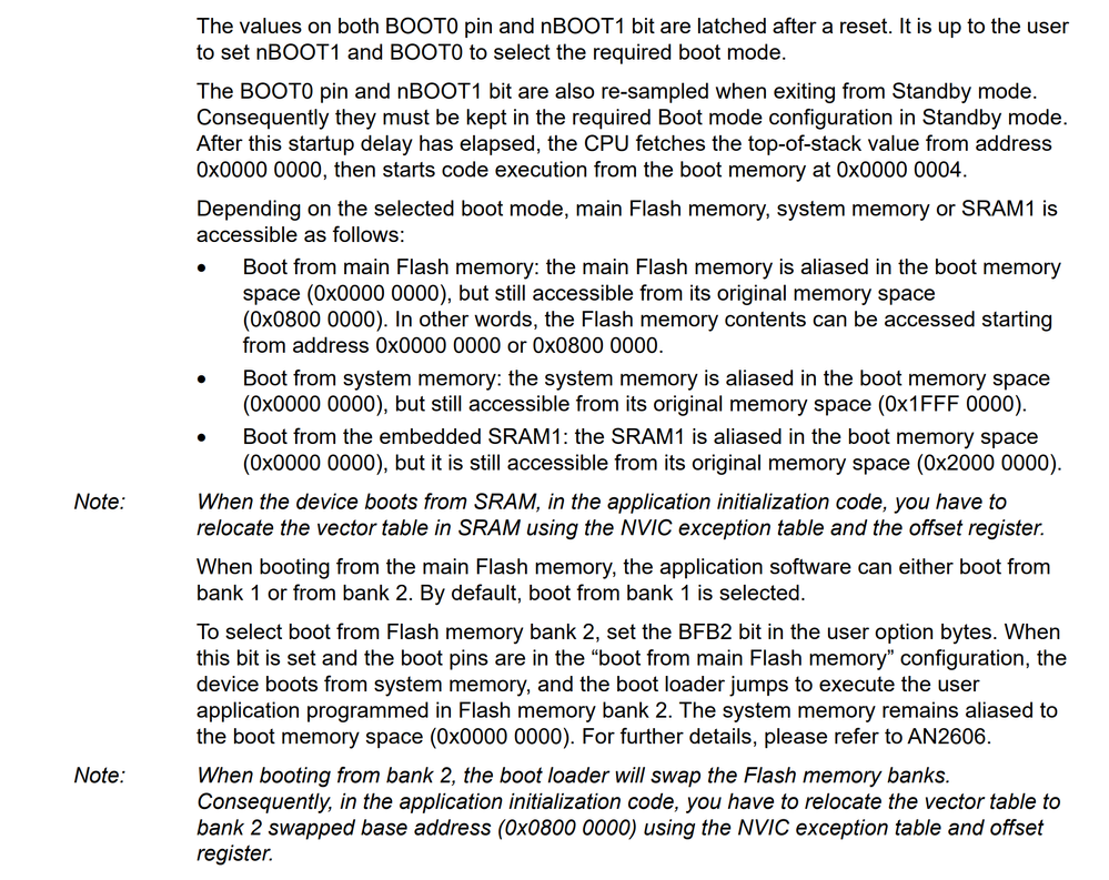

Boot modes for my device.
How the bootloader works.

In file "system_stm32l4xx.c" I had to uncomment "#define USER_VECT_TAB_ADDRESS". After the bootloader started my code the vector table didn't get remaped. At systick interrupt the cpu jumped back to bootloader and code restarted.
