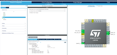

Hello, I am trying to wire STM32F103C8T6 with DS18B20 sensor and I realize that after some actions it stopped to work and no data through the UART sent:
Probably it's not big deal, but I have no idea why UART completelly blocked and sending no information.

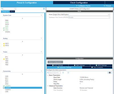

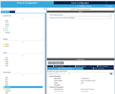

I extended buffer size but unfortunately nothing changed...
Can be something wrong with configuration I applied?

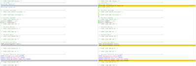

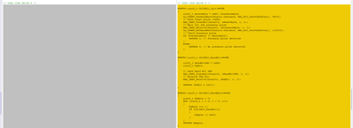

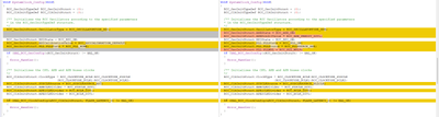

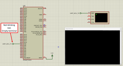

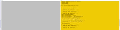

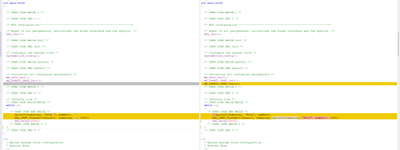

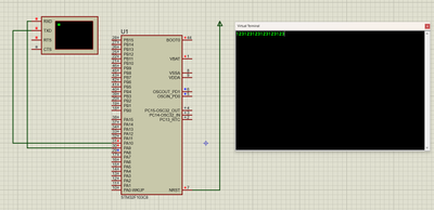

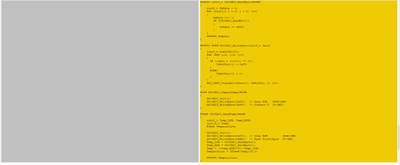

Here is the example of simplified versions from Proteus. So generally, it can recognise the environment and working with UART.
I don't have this temp sensor right now. Code comparsion between this simple UART example and code I plan to adapt. Left version is the code which works:

2025-03-01 6:25 AM - edited 2025-03-01 6:31 AM
Proteus has a debugger which allows you to step through the code - doesn't it?
So have you done that?
It also has "virtual" instruments (akin to oscilloscopes, etc) to observe signals external to the MCU.
Have you used them?
Have you got the UART working without the DS18B20 sensor?
