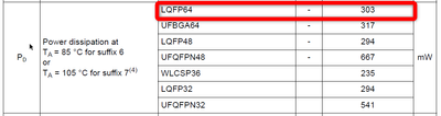

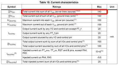

What is the max power consumption of the STM32L412RBT6?
Hello, I am estimating the max power consumption of the STM32L412RBT6. Based on the datasheet, I got two results, one is 303mW which is on page 78, and the other one is 0.462mW, which is on page 76( 3.3V X 140mA = 0.462mW). Please guide me on which o...
