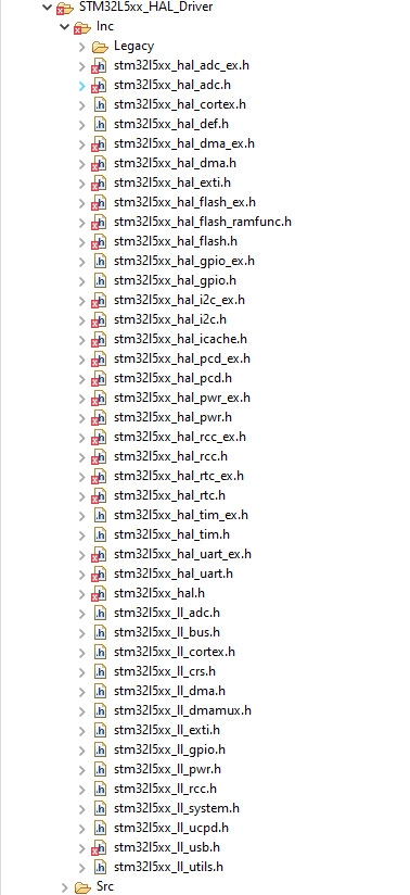

I tried that. Everything broke rather spectacularly, and I tried again after I found a possible error. The end result is practically everything in the HAL_Driver folder hitting me with a big red X. Also, all types (uint8_t, uint16_t, unsigned long, etc) are now considered undefined.
I'll keep experimenting with getting the code into a normal .c file and see what happens
2022-08-29 8:42 AM
Ever seen a break similar to this one before? It happened when I moved the functions into a new .h and .c file, and I haven't even included the new .h file in my main.c yet. I'm still rather new to CubeIDE, if that wasn't obvious.
